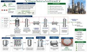

3. Overall Urea Manufacturing Process Flow
Below is a simplified text-based flow diagram of the urea plant:
Natural Gas
Steam Reforming Unit
Ammonia Synthesis (NH₃ Plant)
Ammonia Storage & Compression
CO₂ Recovery from Reforming Section
CO₂ Compression Unit
High Pressure Urea Reactor
Carbamate Formation
Urea Formation
Stripping Section (NH₃ & CO₂ Recovery)
Recycling Loop (Back to Reactor)
Vacuum Evaporation System
Urea Melt Production
Prilling Tower / Granulation Unit
Cooling & Screening
Storage & Bagging
Final Urea Fertilizer Product

4.3 Urea Synthesis Section (Core Reaction)
This is the heart of the plant.
Step 1: Carbamate Formation
Ammonia reacts with CO₂:
This forms ammonium carbamate, an intermediate compound.
Step 2: Urea Formation
Carbamate dehydrates to urea:
Overall Reaction:
4.4 High Pressure Reactor Section
Operating Conditions:
- Pressure: 140–250 bar
- Temperature: 170–190°C
Process Description:
- Ammonia and CO₂ enter reactor
- Carbamate forms instantly
- Partial conversion into urea occurs
- Mixture exits as urea, carbamate, ammonia, water
The conversion is not complete (about 60–70%), so recycling is required.
4.5 Stripping Section (Recovery System)
Unreacted gases are separated using a stripping process.
Purpose:
- Recover unreacted NH₃ and CO₂
- Improve efficiency
- Reduce raw material loss
Types of stripping:
- CO₂ stripping
- NH₃ stripping
Recovered gases are recycled back to the reactor.
4.6 Carbamate Condensation & Recycle Loop
Recovered gases are:
- Condensed into ammonium carbamate
- Returned to reactor feed system
This recycle loop significantly increases plant efficiency and reduces operating cost.
